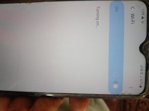

Why is my wifi and bluetooth not working
Why is my wifi and bluetooth not working Why is my wifi and bluetooth not working
crwdns2889612:0crwdne2889612:0 100
crwdns2944067:029crwdne2944067:0
Has the phone been dropped or damaged at all?
I did factory reset but still not working
I went in my hardware but my wifi and bluetooth are not listed in and its says unavoidable
What must I do

الخلل في ايسي بلوتوث والحل استبدال الايسي او تسخينه راح يرجع الجهاز طبيعي
Google translate:
The fault is in the bluetooth eSee, and the solution is to replace the eSee or heat it up, and the device will return to normal

If your WiFi and bluetooth not working it is because of Ic problem you have to change it

It's a hardware issue. The phone's IC has a problem that's why the Bluetooth n WiFi don't work. The technician will demand approximately R250 to R350 to fix it.
No hardware issue this is new update issue.
Not an update issue. My phone has not received an update in years because it an old phone (Galaxy J5 prime). So it is a hardware issue-

Heat ic 300 ⁰c but how can i show the ic

Its hardware issue my 2 devices one got resolved heating ic and second one had replaced ic MT6631N
