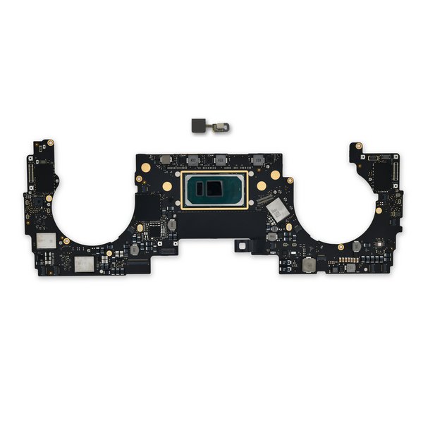

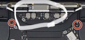

If you open it up pay close attention to the cpu area with the big silver squares (coils) if needed you may need to look on the other side for anything alarming:-)
Hi
Here’s the area to look at for now
Thanks:-)

Is there a video you can recommend? When I opened the device I did not immediately see any coils
Alternatively, is there a benchmark if expected temperatures for certain activities?
Il add a photo to my answer of the area to look at
