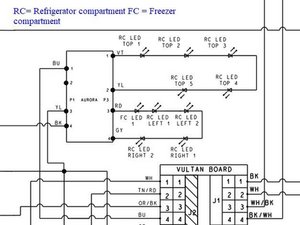

I have a KitchenAid French door refrigerator. # KRFF707ESS01
serial # W10695459
the Freezer LED quit working a few months back. I found them from my local supplier for $30 each.  I decided to wait because I could find some at work if I were patient.  I work at a facility that reclaims Freon and scraps old appliances.  I just have to keep an eye out.  A few weeks ago, finally one arrived.  It was a whirlpool but had the same LED’s.  I removed about 5 and thought I was set.  I searched how to remove the freezer drawers and access the LED.  No issues.  Except,  it didn’t come on.  I found out today the freezer LED is a different part number and $100 apiece.  Also the 4 LED’s on the side the refrigerator compartment are out as swell as the one towards the front on the left.  Ice maker side.  It flickered a bit but went off.  My question is what’s the difference in the lights in freezer and Frig?   What is the circuit order, as I leaned the circuit is continuous?  Do I have a bad LED Board?   $400 bucks?  I’ll keep a flash light in the door shelf beside the mayo!   Thank you. Merry Christmas 🎁🎄

I don't what the difference between the freezer and fridge LEDs is but as LEDs are diodes i.e. only conduct in one direction, did you connect the freezer LED and refrigerator side LEDs to the LED board around the correct way and also between the freezer LED and the refrigerator LEDs and the other side refrigerator side LEDs as well? If any of the wiring is reversed, they won't turn on as it is a series connection.
All the LEDs have to be connected in the same direction polarity wise i.e.leaving P3/3 to +ve side of freezer LED #1 then -ve to +ve through all the left and right side refrigerator LEDs to P3/4 on the board i.e. -ve side of last LED in string- refrigerator right side LED #2 goes to board P3/4
Here's an image from the tech sheet for the refrigerator showing the LED connections to the board.
(click on image)

There are 5 LED's in the freezer LED circuit - 1 in the freezer and 4 in the sides of the refrigerator. Usually LEDs require approx. 3V each to work so that means the 15V DC should be on the output between the LED power board P3/3 and P3/4. P3 is the connector designation on the board and the power is supplied on pins 3 and 4 of the connector.
The refrigerator top lights are connected to P3/1 and P3/2. Since they work if you have a voltmeter if you connect it across P3/1 and P3/2 and open the door you can measure the voltage at that point. Hopefully it should be the same at P3/3 and P3/4 when you open the freezer door.
If you get voltage on the connector and the LEDs don't turn on you've either connected them around the wrong way or they are faulty.
If you get no voltage on the LED power board then either the board is faulty or the door switch may be faulty because it tells the control board that the door is open and the control board tells the LED power board to turn on the power to the freezer LED and the refrigerator side LEDs.

Not sure if this is what you're planning but maybe use your measuring device and check if there is voltage at the P3/3 point and also on either side of the freezer LED
If you're planning on bypassing the freezer LED to turn on the other LEDs then this will expose them to a higher voltage than what they're designed for in this circuit and you could end up damaging them
e.g. 5 LEDs require 15V so each LED is 3V (15 ÷ 5 = 3) but if you by pass 1 LED then 4 LEDs share 15V (that doesn't change) so each LED then has 3.75V now across it. (15 ÷ 4 = 3.75)
It doesn't sound much but it also means an increase in current through the LEDs which may cause them to run hotter so they are brighter but may also burn out quicker
