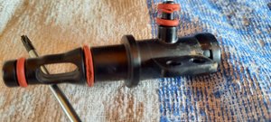

Coffee ends up in waste container
Really hope someone can help, have tried to disassemble, but there is no apparant problem. (The model is actually HD8652 but is was not in the list)
Water functions, but when brewing coffee nothing comes out the nostrils, but some end up in the waste container. Have tried to clean with needle off course
Hello same problem with philips série 2230.
Saeco or philips are same machine .
You have to verify joint on the pipe behind Coffee extraction group.
