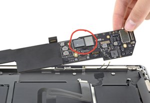

I have a 2020 M1 Macbook Air that I removed the antenna bar from.
See example pic here:
https://guide-images.cdn.ifixit.com/igi/...
The problem is the laptop is still able to scan for Wi-Fi networks despite no antenna bar. How can this happen when I physically removed the hardware? I would like to completely airgap the system
Radio waves can even emanate and be received just by the antenna studs on the logic board. The only difference is the level of signal that can produce or receive and the amount of signal blocking the case offers.
So just like you take off the exhaust pipe from your cars engine the gases don’t stop they just leak out where the pipe was cut.

The issue is that the actual WiFi/Bluetooth antenna bar doesn't contain any of the actual driving components for Bluetooth or Wifi. The driving components are integrated into the board, and can only be removed if you have micro-soldering skills.
However, @danj did have a good alternative solution to this in a similar question. To sum it up, all you should have to do is turn off the WiFi and Bluetooth services through the OS and set up a second user account with the services disabled by admin.

@lopptony Like any technology that uses radio based communications, an antenna is necessary to “collect” the ambient signal. Old school radios, cell phones and even TVs had external antennas to better collect this sort of signal. Most of this is done with internal hardware now, so people don’t often think about them but all the surface area which used to be present on the outside of hardware is just internal now.
There is likely a noticeable difference in potential signal strength and integrity between a Mac with the antenna bar installed and one without. You may be able to scan for and see WiFi networks with the antenna bar removed, but you may not be able to connect to the network or stay connected if the antenna bar is gone.

On the under side of the logic board(the opposite side of the one in the picture)there is a chip that looks like a SSD(SSD’s highlighted in photo)
I believe that is the WIFI chip
I don’t recommend removing this as it requires applying LOADS of hot air onto the board to melt the solder and unadhere the underfill which can reflow things and even worse burn the board
It’s entirely up to you ,so Il let you decide;-)
Hopefully this helps
Any questions please ask
Thanks:-)

1. So you are saying that the antenna bar I removed is not responsible for Wi-Fi + Bluetooth but instead that's done by a separate chip fused to the board itself?
2. What is the function of the antenna bar then?
3. The red circle you highlighted in the picture is NOT the Wi-Fi chip, but it's on the other side of the board not shown in the picture, right?
@lopptony
The WiFi antenna bar is for getting a better signal, the chip will work with out the bar ,just not very well
The red circle highlites the SSD the WiFi chip looks like a SSD but it’s not,it’s on the opposite side to the SSD:-)

Sadly you can’t take out the chip without creating other problems. Using multiple user accounts is the only way you can do this in this series as unlike the linked answer I wrote that Jacob aimed you to the M series systems are much more integrated.
