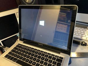

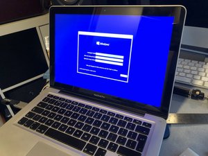

Update (12/12/2022)
With a separate drive to install Windows there is no need to use BootCamp. Here I have a 2012 MacBook with the Windows USB installer inserted. Holding down the Option key when booting the Mac will allow you to boot from the USB drive and install Windows on any internal SSD or HDD. If you have made the BootCamp disk it may be useful as a source of Windows drivers but you can usually find better ones elsewhere.

I'm suggesting you put the Windows USB installer (created on a PC) into the iMac and boot from that. So you'll be running a bog standard Windows installation onto the internal SSD. Hold down the Option/Alt key to choose the USB stick as the boot disk.
