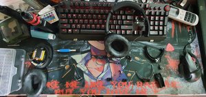

I've posted this as an answer as I can't edit the OP post. I too had this happen and am looking for a fix that isn't super glue here are some pictures.
These are some pictures I took of mine torn down.
As shown in a couple of the pics, I found the part that was damaged on my set and it's not repairable but it is defineitley replaceable.
