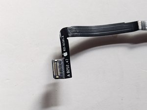

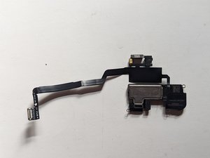

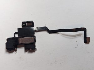

Okay, on to the second issue, Face ID. Here are some pictures of a genuine Apple earpiece speaker assembly.
You'll note there's an Apple logo on the end of the connector, although its presence doesn't necessarily prove anything since Chinese imitators frequently copy logos and part number information on their reverse-engineered parts, but if it's absent that would be a strong indicator that it is a replacement flex.
As far as the data programmed into the earpiece speaker parts, that's entirely different from that used in the True Tone information. For True Tone, it just has to have a serial number that matches the data in the phone, so a simple copy operation fixes that problem. With the Face ID, that data is generated by a proprietary encryption algorithm and presumably includes unique data from the earpiece assembly and the phone itself. As such, it's impossible to recreate without access to that algorithm, which Apple doesn't even share with its authorized service centers; they can use it remotely to do Face ID repairs, but they never actually get a copy of the program.
I totally forgot about Apple logo near the connector I looked under the microscope and it was not there, saved me ton of time and nerves 😅
