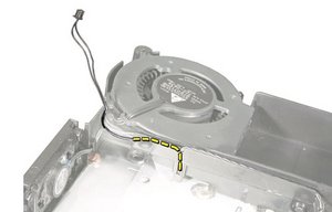

Often when I see or hear of a fan issue it’s either bad or the symptom of SMC going into CPU safe mode as one or more of SMC sensors have become disconnected or failed so SMC is trying to protect your system from damage.
Here’s the guide getting to the fan and the part Mac mini Model A1283 Fan Replacement
