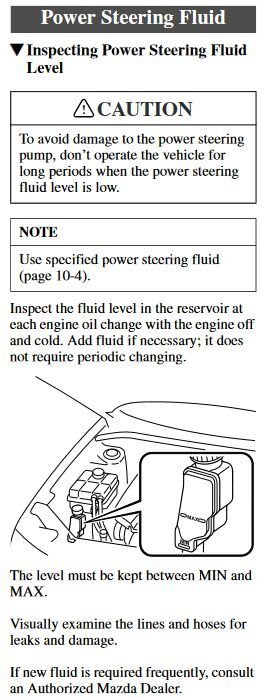

Check if the power steering fluid is the correct level and that there are no obvious leaks near the power steering fluid cylinder etc.
Here's some images form the 2004 Mazda 3 owner manual that may help.

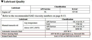

What type of fluid should I add. I don’t have the book for all that information. Which is do I have to buy. Car type Mazda 3 2004 1.6 diesel
@mzemar119 Your car is like my Volvo; it uses automatic transmission fluid for the power steering. The type is circled in red on the last picture @jayeff posted; go to an auto parts store and ask for a quart of Dexron-III (say "Dexron three" transmission fluid.
