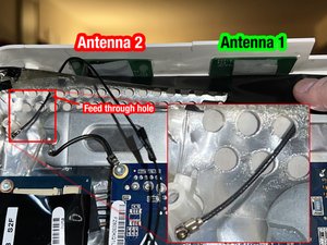

Detailed tests I did can be viewed on this image:

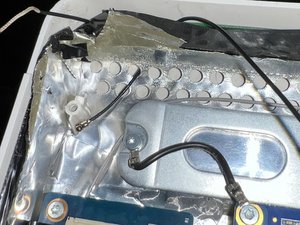

How to:
1) Mount the antenna + board combo at the inside-top of the iMac, to the left of the original antenna. I used double-sided tape, but it wasn't holding well, so I added a little kapton tape to the sides of the antenna board, and was careful not to block any real antenna parts. Foam tape may work much better.
2) Feed the cables down the side, following a similar path of the original antenna, and connect it to the 2nd antenna port on the wireless card.
Quick note: I'm using internet as a gauge, since my LAN can vary by test connection, and I wanted something optimized for network packets. I'm seeing about the same results when running file transfer tests to my Mac Pro (that I use as a file server).

Thanks for your feedback. According to the OS, I’m getting around 121-162Mbps off of one antenna. I just used 150Mbps to generalize. I think getting the 2nd antenna is going to worth it, unless someone knows an odd technical why it wound wouldn’t in this iMac. I even have a 3 antenna card, maybe I’ll get 2 more for 3 total lol.
Good idea, but sadly harder to do in this iMac. Just connecting the cable won’t work as the systems shell acts as a shield preventing the signal in or out. If you note the WiFI antenna is where there is no metal shielding in the back. You need to mimic the second antenna at a distance from the first.
Thanks for your input! I ordered the 2nd antenna last night before seeing your comment. If it’s just a shielding issue, I’m happy to experiment with antenna placement, and maybe even remove some of the frame (as long as it doesn’t wearing the structure beyond a certain point). I’ll let everyone know how it goes.
@Rick Karrer - So what did you discover?
Hey everyone! It works great! I did a bunch of tests, and have photos and screenshots I want to put together when I get a chance, but the short answer is it works as I hoped. I could even put a 3rd antenna in and use another card, if I wanted to, but that card isn’t currently supported in 10.4. I have 10.4, 10.6, and 10.8 (hacked) installed in this iMac, and while I’ll mainly be using 10.8, I prefer to keep the 10.4 for nostalgia’s sake.
