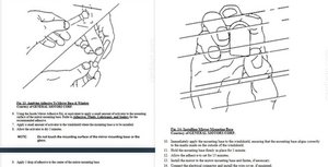

How do I reattach interior mirror on 2015 equinox?
My review mirror detached from the glass. How do I reattach it? Do I need to remove the black plastic around it?
If it is detached from the glass, you need a special glue available from most auto parts store specifically for that purpose.

Here's some images from the repair manual that will help.
(click on image to enlarge)
