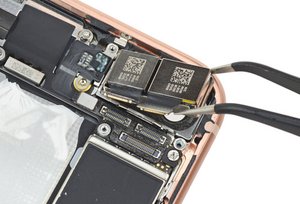

i'm transferring the innards and screen of my iphone 8+ to a new back case. in the disassembly and removal i came across 3 parts, one of which i know the name, that i don't know where they came from, and i can't find any reference to them in any of the ifixit guides.
This is the bluetooth antenna flex cable - where does it go?

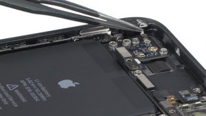

This, not sure if it's a bracket or antenna, goes somewhere in the upper left, near the wifi antenna cover, but in my phone it's broken, so i'm not sure of the location or orientation.

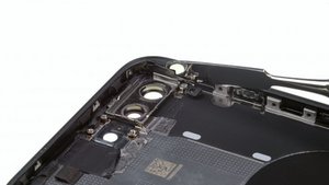

This, is probably a grounding clip, but i have absolutely no idea where it goes, and the original was was broken as well.

The first one is an antenna, I believe for NFC, and sits between the rear camera and the outer edge of the housing. You can see it here. One end attaches under the standoff at the other end to the “wall” of the housing.
The second one is a grounding bracket for other antenna functions. It’s in the upper left if the phone, under the plastic bracket there. It bends over the edge of the phone.
The third, I’m not sure off hand. Probably something minor enough that would be okay without it. But I will do some extra legwork and see if I can find a picture of this anywhere.
The 1st one is actually for NFC.
@tomchai You’re right it is. Idk why I always think Bluetooth.
Top one next to rear camera between it and the frame. Middle one top left of the phone between antenna and frame. Bottom one top right of bottom speaker. Should be a screw just above the speaker.

Okay, the part in the first picture goes in the upper right corner, under the part identified as the "guide rail for the iSight camera". Thanks to iDoc's iPhone 8 Plus back cover repair guide, here's a picture of it in it's proper location.
The piece in the second photo goes in the upper left corner, under the part identified as the "Top Left Antenna".
Sorry, but I didn't find anything about the last part in your list, but I hope what I did find helps.
