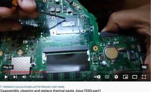

If it turns on (or even if it doesn't) but then the same thing happens again some time later (days, weeks even) it may be that the RTC battery (Real Time Clock aka CMOS battery) on the motherboard needs to be replaced. This battery maintains the BIOS settings when the laptop is turned off and when its voltage get too low (usually <2.5V DC) the BIOS can become corrupted.
Unfortunately this battery is mounted on the underside of the motherboard, so the laptop would have to be nearly completely disassembled to get to it.
Here's an image taken from this dis-assembly video that shows the RTC battery on the board.
(click on image to enlarge).
The model number of the battery is stamped on the battery itself, but usually it is a CR2032 which is available most everywhere e.g. supermarkets.
