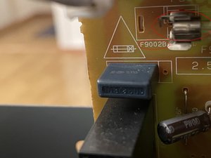

@mikaels No that blueish components looks like a capacitor.
The fuse is the components F9002B (glass fuse on the top right), I have added the picture you posted to my answer above, with red circles :)
Edit: The capacitor will show open loop (OL, meaning no connection) in normal state, and will only show a connection if it's blown (shorted). You can measure the capacitance with your DMM, if the meter has a capacitance measuring mode.

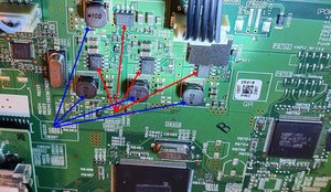

See if you find this setup on your board. Red are the regulators and Blue are the corresponding inductors.
