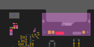

UPDATE - 10/02/2022 - Now that you've gotten the device open, the spots in red are places on the top of the board that are battery voltage. You'll have to peel up the little sticker there. since the battery connector (labelled here as J8900) contacts are all on the bottom of the board. Anyplace that's grey is ground. I usually just use a shield or screw bracket for that.
Battery voltage should be about 3.7 volts. Now that you've got the thing open, I would just have a look at the USB connector as well. The two metal pins on the side you measured, if you mean these two in the pic? Those will be ground so should be continuous, but won't tell you anything. But you should be able able to tell if there is damage to the pins. Pictures of the iPad internals would be super helpful in all cases.

finally opened it i tested for continuity on the usb port that has two metal pins on the side and it had continuity i am wondering however how can i measure the ipad battery volt this one has two ribbon cables
