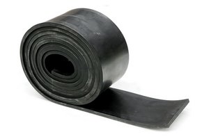

If I understand your question, you are having problem to remove the Y screws. I recommend you buy a precision tool kit, because the home button isn't replaceable and if you damage it, the problem will be more bigger. If you have the tool and you can't remove the screws, try to use a thin rubber to fit the gap between the tool and the screw and have a better grip.
