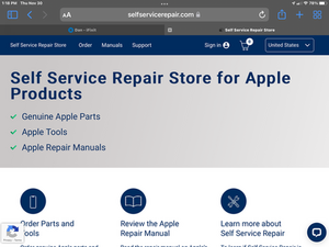

The link for the Apple self service site comes back as 403 forbidden.
Was https://www.selfservicerepair.com/home actually an Apple site? Is it gone?
@maccentric - it’s a real Apple site! I just double checked the link which is good! But! With that said some countries can’t access it and Apple hasn’t rolled out self service across the world yet either!
I’ll post a screen shot of the real site above 👆
