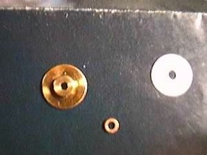

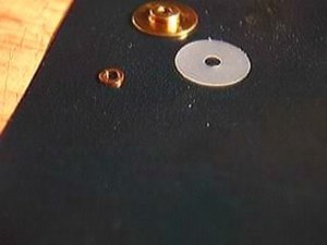

Hello, When I took the base apart and pulled the motor off the base two pieces can off. A brass spring retainer and a clear plastic washer. Where do they go to put it back together, They are not shown in the take apart instructions. Thank

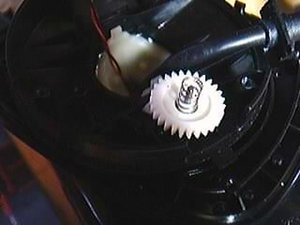

Have a look at THIS pic - under the guys finger you can see half of it.. It appears the brass washer sits in the circular dent in metal base plate.
The SOURCE ARTICLE - step 6
It appears the base is a little different in this article compared to the iFixit teardown- clear instead of black plastic insert in base.
i too would like to know the answer,i have one very small brass washer and a thin plastic one and a larger brass washer and cannot figure out where they go.thanks

So let's # the rings so we won't get lost, and I would be referring to it as #'s
1->small brass ring
2->brass saucer
3->plastic
If you were to examine the kinect, you would notice that there is an opening along the base, assuming you have already removed the plastic cover and your on the metal plate with 4 #0 screws, one is an opening for the wire that connects to xbox and the other one is for a side which exposes a gear.
Examining further, you would notice Hexagonal Screw head which underneath or on the other side is a female nut (meaning a bar is to go through), so with the data we have already collected it is enough or almost safe to say that the rings are to be placed on top of the exposed gear so it should be like these;
2
3
Spring
Gear
a little visual;
1 __
2 __
_|__|_
3______
Spring
Gear
So using a screw to help you keep holding the rings in place, you can place back the gears and the plate without any trouble.
