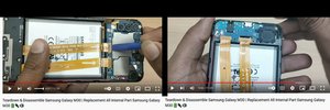

My M30 Wi-Fi is not working properly
My M30 disabled to catch Wi-Fi for a distance like 5-7meters

Is this something that started recently? Has anything happened with the phone; e.g., has it been dropped, gotten wet, software update, recent repair, etc? A little history may help us figure out what's going on with your phone.
Hi @bidhaan
If the WiFi only works for short distances it might be due to a loose WiFi antenna connection in the phone.
Here's some images from a teardown video for the phone, showing the connection points at each end of the phone for the WiFi antenna.
