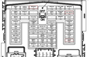

My music is no longer working but I can hear beeps when I switch back and forth

I apologize for the confusion when I click on another area of the screen for example testing out radio stations I hear a beep but no other sounds are coming out. I’ve tried radio, Bluetooth, and cd and usb. @jayeff
How can I check the mute function I have a Hyundai Santa Fe Sport 2016
I have not are there specific fuses for the sound? @rwhurtt
Hi @GiGi TaughtYou
There are 3 fuses in the passenger compartment fuse box (I think and not the engine bay compartment fuse box) that can affect the audio.
They are designated AMP, multimedia and Module 4.
Here's an image (not too good, best that I could manage) showing where they are located in the fuse block.
Double check their location with the fuse designation information which is usually found in the lid of the fuse block.
Maybe check the AMP fuse first.
If a fuse has blown, replace with the same rated fuse. (printed on fuse itself)
Be aware that if a fuse has blown that there's always a reason for this so if you do have to replace it maybe get 2 or 3 of the same rating as it may blow again shortly afterwards.
If it blows again then the reason why this has occurred would need to be investigated further.
