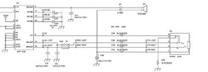

Why there is no sound from the speaker and headphone jack
there is no sound coming through speaker and headphone jack, just the hiss sound
at first i tried cleaning with isopropyl 99%, nothing happens
i have already replaced the speaker with a new one still does not fix
i also re-solder the connection on volume wheel, still no sound

Here's an image of the audio section from the schematics for the game console that may help.
(click on image)
Given that there's no audio heard in either the headphones or the speaker it may be that the U3 audio amp has failed.
You could always check if it has only partially failed by checking if there is audio heard by disconnecting one side of C14 from the board and placing a speaker between U3/3 and earth. If there is then it could be that C14 is short circuit or that C38 is open circuit.
The other check is placing a speaker between U3/12 and earth and U3/15 and earth and check for audio in case there is a audio for the L & R headphone speakers.
If there is no audio heard at all then either U3 has failed or its not getting an input on U3/7 & 8 for some reason.
Make sure that there is voltage on U3/4 & 14 (VCC) and also U3/5 (VDD5)
Hopefully a start
