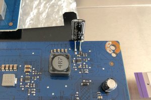

Monitor won’t switch on. How to troubleshoot if PSU?
Switched on the monitor after a week away and was fine for about an hour. Heard a pop and it went black. Suspect it’s the PSU. I bought a replacement monitor since I needed to get back to work. Now that I’ve opened it up, the power supply board looks physically fine. Expect perhaps a blown cap or something. How would I go about checking if I should risk buying a replacement board off eBay etc.

Eugene Khoo you can't add images in comments. Only Question or Answer. Edit your QUESTION and add images according to this guide Adding images to an existing question Check the rectifiers, they love to go on the fritz as well. Anyhow, hopefully we can give you a better answer when we see.
I have almost the same issue with my U2718Q - Switched on the monitor after a two month away and it was fine for about half an hour. Heard a pop and it went black... But I can see burned ceramic capacitor on main board (upper right corner if inputs are at bottom, C962).

Hi Eugene, mine U2718Q is OK now after removing two fried capacitors (C962 was burn to ground and C963 looks OK but was short circuited) and replacing it with some random capacitor. It is around 14-18V at this capacitor so I take 220uf 25V and now monitor works fine for couple of days.
For conspiracy theory adepts there even a cut-out window in metal shell for easy replacement of this capacitors without tearing everything down... ;)
Random capacitor was temporal solution but now I'm too lazy to replace it with SMD one.

I love you man! I just did the same as you indicated and the monitor came back to life. The only thing I did differently was that the capacitor I used was 100uF / 50v and I noticed that the monitor took longer to turn on. 'I'd also like to look for SMD one, but I don't know what the indications will be. Big thanks again

Thank you so much!!! I didn't even find a capacitor to replace it but the monitor started working again after I removed the C962 and C963.
It also worked for me. c963 was short circuited. After removing this capacitor the Monitor is working fine again with no further problems. Thank you guys for your hints!
