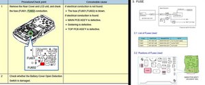

burned my canon A470?
I plugged in a 6v charger to camera , it flaged, one and doest work after that
Hi,
Check if fuses FU601 & FU602 are both OK. Hopefully the DC/DC converter wasn't affected
Here's an image taken from the service manual for the camera, showing the location and Canon part number for the fuses.
If a fuse has blown search online using the part number only to find suppliers that suit you best.
The manual also shows the dis-assembly procedure that will help.
(click on image to enlarge)
