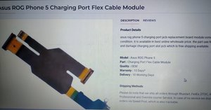

So, One Day I tried opening my phone on my own and discovered the issue.
Found one connector (Charging port Flex Cable module)
was pulled out and pins were bent.
I will attach the Photographs.
