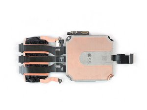

Apple watch series 5. What are these cables on the display?
Can anyone identify the 2 pictured cables?
They are the EMI shield connections to the watch case to prevent signals to/from the display and the S5 SIP unit.
Here's a better view from the other side
Here you can see the three cables being shielded.

Both of those cables pulled loose / tore away from the display. I've not been able to find replacement cables and it doesn't appear they come with the replacement display cable. Any idea on where to find them or can I do without?
@bad_karma - Yes, they are easy to tear!
I cheat! I use conductive tape patching the exposed foil side. That way the emissions have a way the case.
Do you have a picture showing what you have described above?
@bad_karma - Here's the needed tape Conductive Electrical Tape All I do is cut a piece place it across the copper surface and lightly tack it down with solder.
@danj not quite sure I follow you. My cables tore from the pad that is secured to the case and also from the back of the display. Am I simply using the conductive tape in lieu of the cable? If so, how do you fasten it to the case?

@danj: You can see in this photo that the small cables are disrupted on both sides. Are you suggesting that I solder one end of the tape to what's left of the cable at the case end and the other to the shield itself?
Re-read what I wrote. I clearly stated one will need to apply a thin strip of conductive tape to patch the break. Soldering is only an option when the tear doesn’t offer enough surface. I also stated one strap often is enough.
