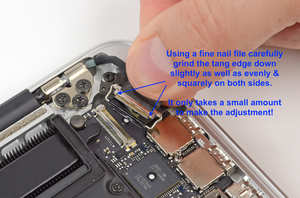

Update (07/08/2022)
To allow the older 2011 display to work with the newer 2012 board do the following

Frankly, I would look for a 2012 logic board as being the better direction! Surprisingly both 2011 systems can also use the 2012 board with one slight modification with the LVDS cable as I've pictured above.
