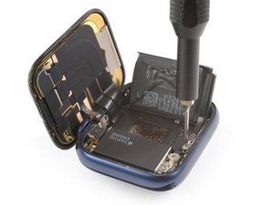

Hello! I'm trying to identify the third black strip when you first open the watch that isn't a part of the display flex cable. I'm unsure if it's just tape or a cable. Can someone help me identify what it is?
Update (06/25/2022)
The watch is currently taken apart to replace the display flex cable, but this is a photo of where it disconnected.

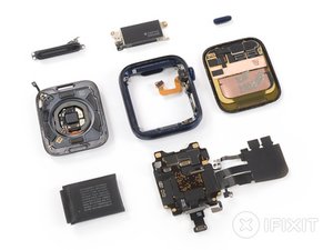

Sara - The grounding cable alone is replaceable!
Loosing the two screws which hold the thumbwheel assembly and then sliding in the new cable as its caught by the bracket (don't forget to take the small piece thats still there)

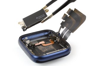

Here's a better picture of the display cables
And now with the cables disconnected from the display unit
The thin cable is a grounding cable to link the displays ground to the watch bases ground. This has two functions one to dissipate static discharge you might have and to control EMI noise
Its anchored within the crown wheel unit and the foil sheet which is applied to the back of the display.

Depending on the damage it may not matter as the cover shield still works with one leg. If both are cut then you made to get a new shield piece. If the data ribbon cable is damaged that’s really the end of the watch as The whole logic unit (SIP package) will need to be replaced as the cable is not offered as a part.
