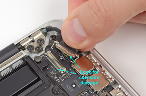

Inspect the LVDS connector

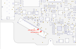

These are the lines you need to look at

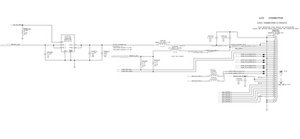

Here's the pin assignments

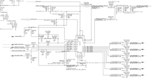

Here's the driver logic if you don't see any issues at the connector.
You might need to look at the display assemblies connector too!
