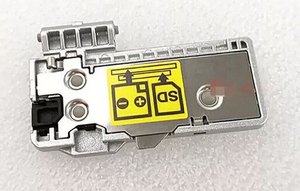

Repair broken battery cover
Does anyone know how to place all these pieces
back into the cover
You seem to be missing the plastic cover. The picture you have are the metal internals and the C Unger photo is the plastic parts. You need to attache the two together. It was done with melted plastic from the factory.
Here’s what the assembly looks like complete
I don't think you can put these parts back together to make this work. It appears you are missing the screws and it also looks like the plastic is damaged.
Basically you need a new battery door assembly. Olympus Corp has spun off its camera division as they have stopped making cameras. You'll need to contact them see if they can ship you the replacement assembly. I'll warn you they are very possessive with their manuals and parts. They will try to get you to ship the camera to them for repair and it won't be cheap!
Play the heart strings as best as you can, I've managed to get a battery case from them with tears running down my face to break their will ;-}

You might want to look locally for a repair shop they may have the part, or look at finding a parts system.
Leire Diez Larrea unlikely that you get this "glued" back together. I suggest that you replace it. Parts are available at places like this and on here as well
Depending on where you are, you can also check for original Olympus parts right here
The door flap to close my batter door broke. I ordered a replacement battery door for my Olympus E-M5 II and it was simple to install. The part was about $25. Was all looking good but the camera did not work after the new part was installed. Quote to get a repair shop to change the door part was $250.
Assuming I am now going to have to pay up for the big bill to get it working.
Battery door needs to be bonded together.
