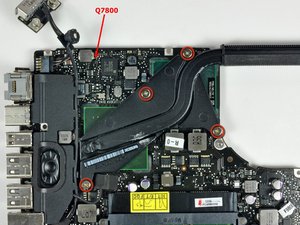

Good afternoon. Need help identifying a component that has deteriorated due to oxidation on the board. There were two faulty components an inductor and a component that appears to be a transistor but is very small.
There are other similar components on the board, but I can't identify them.
The first image shows the location of the component, very close to the coil that is damaged:
Here's an image of the component similar to what's missing:
The rest of the board seems to be ok, just missing this to revive this monster!
Thanks to anyone who can help!
wagner.m.v that is reference designator Q7800 which is a SSM3K15FV N-Channel Mosfet in a SOT-723-3 package.
