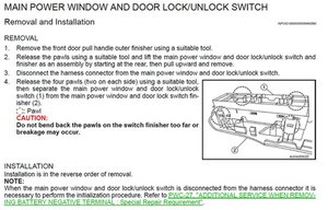

@kadyboon Master Window Switch?
@kadyboon just in case you are taking about the Main (master)Window Switch. This explains how to do it and what to do after. A proper tool would be something like a small putty knife etc.
