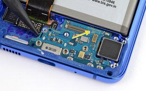

My S20+ port got moisture problem, so i bought a replacement charging port on ebay. here is with i found
  1. disconnecting and connecting OG charging port fix the moisture problems but randomly happen again in between 1 to 3 week
  2. I get no network if i boot with replacement charging port.
  3. If i boot up with OG charging port, then change it to replacement charging port. everything works Till i restart the phone
why is this happening? is samsung blocking third party parts?

but yeah, i meant the whole USB-C Charging Port. my phone is the Taiwan model(i am in UK currently), the G9860, i made sure the replacement part is for the G9860(its printed on the board).
If its incompatible parts that is causing the network problem, it should just not work at all, they fact the changing part works mean its not a hardware problem right? i actually went to a third party repair shop with the same result.
oh, i just noticed the above pic is the exactly same as my replacement part(all the model number matches)
but my OG part is slightly different compare to the above pic, highlighted the red circle from picture of my OG part

I assume when you say you replaced the charge port, you replaced the whole daughter board with the charge port on it? If so, there are 2 variants of this board. One is the international variant and one is the North American variant and although they look very similar, they have some differences, one of which is related to cellular function.
On the board, there should be a model number/board number. Check to see if the two you have match. The North American version is a G986U, the international version is a G986B. The numbers are not in quite the same location on each board, but here's a picture of the North American version so you know where to look.

But, if both parts are the G9860U (as opposed to B), and it sounds like they are, if only that one component is different, that could be the issue, depending? It IS odd that that spot is populated on your original board. Any of the pictures I have found of replacement components just have blank pads there. I can't tell from the picture, but does that component have any writing on it? The one that is circled in red and is present on the original board, but not the replacement? You mentioned the phone is the Taiwanese model, do you have the model number of the phone itself?? It should be on the back glass in tiny little print or in the settings of the phone.
Also, I assume the repair shop you took it to installed their own part, rather than the one you purchased?
I had a humidity error and changed charging modules. No service as you stated. Shop requested a new charging module from a different lot to rule out faulty lot. Same result. The third time the technician spoke to me and after one day he gave me back the working phone. What he did was take the original module and replace only the charging port taken from a new module. As it is a local shop in Europe we can rule out the have North American parts. What he explained (and this is a Galaxy A52S) that there are different versions of the module ( not build wise but SW wise) and the phone simply reverts to no service. This also actually happened with the January security rollout from Samsung (which nauseated me as to why Samsung can’t get their $@$* together), I believe it’s K1 and K2. If you go to a Samsung shop they either have the correct version burned module or they simply reprogram it on a new module. A local shop either knows about this or are clueless and might even change the network chip or the whole PCB..
