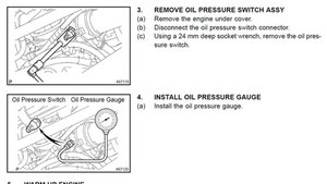

iv got a 05 Toyota 4 runner 4.7 where is the oil sending unit location
Dustin Gibson not sure what you are referring to by "oil sending unit" the oil pressure switch is right next to the oil filter but you need to remove engine under cover 1 (that is the front one underneath)
