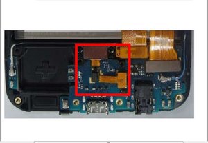

Fsasil Nega follow the Samsung Flowchart. All those parts are located on the sub board. That is the daughter board where the charging port etc. is mounted to.
Make sure that the flex from the main board to the sub board is properly seated and has no tear etc.
Here is the location for the finger sensor
