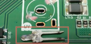

I've managed to open the back of the monitor. Images attached.

Test connector
I was unable to get the red probe deep enough into the connector, so I put it on the metal coming out of the connector, see red circle below. The black probe on a screw on the board, see black circle in the image below.
The multimeter was set to resistance mode, and it beeped.
I also tried the multimeter on two other resistance settings. First on a setting of 200, the reading was 01.0 then I changed the setting to 2k, the reading was .001
Test connector with power cable
Set multimeter back to DC voltage mode, setting 20. Plugged power cable in and turned the power on. Black probe on the same screw as before, and red probe on L713 , gave me a solid reading of 19.20

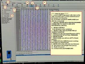

I fixed my monitor by reflashing firmwware on EEROM chip with dump file I found on on badcaps forum with CH341A programmer. As I have seen, a lot of these monitors have same issue, they just wont turn on. no sign of life. By just reflashing the EEROM chip problem can be solved. You even dont need to desolder the EEPROM chip, just hook up CH341a on to it and reflash it. Hope this helps.LG 34UM95 Badcaps thread, dump file, it says lg34um95-p but it works also on non p version.

SOLVED WON'T TURN ON - LG - 34UM95-P UltraWide
  • steps for glory ********
  • buy CH341A programmer with clamp, you will connect the clamp on the USB on 25 socket, check picture (it has 24 and 25, connect in the direction of picture below)
  • you will reprogram the chip EEPROM (BIOS) ML25L8006E - using the USB, the CLAMP, a software and a PC with windows
  • unplug your monitor LG 34UM95-P from wall 19V adapter
0-connect USB Programmer with clam on the chip correctly in pin 1 on the motherboard of the monitor LG 34um95-p
0b. LG monitor should be UNNPLUGED (not with 19v connected) - RED light on dongle will ON
1- INSTALL DRIVER WITH USB PROGRAMMER CONNECTED TO YOUR PC AND WITH SUCCESSFULL INSTALL
2- on software select DETECT
if ok will detect a few variations
3- SELECT ONLY ML25L8006E FOR LG 34UM95-P MONITOR
4 - READ: if ok will read actual firmware (100%) -- GREEN light on USB dongle will flash
5- SAVE: BACKUP OF ACTUAL FIRMWARE on your PC
6- press ERASE, then BLANK
7-READ AGAIN, you will see all FF and ...... of blank memory of the EEPROM CHIP
8 - OPEN and select NEW firmware working (from link) LG 34um95-p.bin
9- press WRITE ( and wait 100%) this will write new firmware
10-disconnect usb dongle from your pc
11-PLUG the monitor with 19v power adapter
12- it shoul work and POWER ON!!! :)))
software https://tecmikro.com/documentos-software...
firmware working LG 34um95-p.bin https://www.badcaps.net/filedata/fetch?i...
this is another exampled how to use USB (in this case on a motherboard pc)

Hi @stephenmeehan
I am almost certain that the issue is your power connector on the monitor. Especially because the white buzzing noise that you mentioned in your question.
These wider monitors usually operate on a 19V power supply with currents up to 3.5-4.5A. The connector is similar to a laptop DC IN connector with 2 inputs (V+ and GND) and usually they are soldered on the motherboard by 3 or 4 legs.
The static noise you heard was probably a leg come loose in that connector due to physical and/or electrical stress (almost 85Watts) at this tiny connector it may be burnt and/or broken and that is why the monitor is not turning on.
If you are able to take the monitor's back cover off and measure the input voltage, which should be 19V on the connector, you should see either 0V or a non stable voltage if you move the cable in the connector. If this is the source of the fault, you can desolder old connector and get a new one soldered in. If there was a short created by the loose connection at the power input, you may have a blown fuse on the motherboard as well.

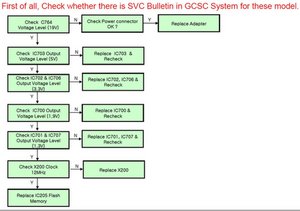

@stephenmeehan For now just start using the LG flowchart for the no power situation. If you show 19V on C764 you know your jack is okay and you can move past it.
Update (06/12/2022)
@stephenmeehan finally found the rest of it too. Check the IC's according to their required voltage. IC 703 and all the other IC's are pin 8 to be checked for the proper voltage. Looks like this beast (monitor:-) had issues with it's EEPROM. Looks like a lot of people(weirdly enough mostly Eastern European) flashed the EEPROM. Anyhow, this LG 34UM94 95 should help you getting your monitor back on the road :-)

Like the OP I found this very helpful & informative. What's the reason that only IC703 has voltage checked on pin 7 and all others in pin 8?
@electricfish Good catch. Just rechecked the schematic and they are all pin 8. Answer has been edited to reflect this information. Thanks @electricfish
