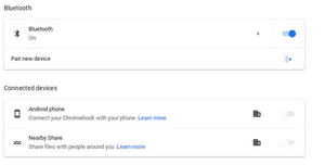

Edit: I think I may have figured out the issue. If you have an Android phone, then Chrome OS pairs to it using a new feature, "Pair with Android phone", under Connected Devices, not Bluetooth.
My Chromebook is managed by an organization, so I can't confirm if this works, but I definitely can show you where the setting is.
Perhaps it is a 'feature' not a flaw. In researching your problem I found this on Google's Chromebook support page:
"Tip: Your phone cannot pair to your Chromebook with Bluetooth.'
