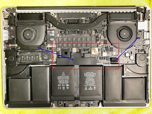

Temperature sensor locations for 15" 2015 MacBook Pro
Hello. Just replaced thermal compound on 2015 macbook pro. Upon restart the fans slowly ramp up to full and the computer runs slow. Also diagnostics is saying SMC issue. with code PFM006. I'm trying to identify the temp sensors. are they the round spongy things to either side of the CPU and graphics chip?

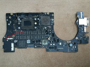

Keir Briscoe PFM006 - There may be an issue with the System Management Controller (SMC). Apparently it can also be popping up with a failed trackpad cable/connector. What board is this? The voltage sensor is a simple resistor from which usually comes from a 3.3v line straight to the SMC. So if the resistor is good and traces are good then the SMC-Circuitry will be having issues. Let us know the exact logicboard number 820-xxxxx and post some good pictures of your board with your question. That way we can hopefully point things out
oldturkey03. have added a photo of the logic board on my original post.
Thanks for the help on this. I super appreciate all the feedback and education I am getting here!
Keir Briscoe the 820-3787 would be for a 2013 to Mid 2014. The attached picture shows your board? If so then that board is a 820-00163 which will make it a 2015 MBP. Bottom left on the logic board shows it ;-)

@Keir Briscoe - Reviewing the schematics is how I know its a current/voltage sensor. At this point its a deep process the isolate out which sensor is firing off and the reason could be a few possibilities.
One action was when you cleaned and applied new thermal paste there are a few SMT components on the chip carrier which could have been damaged and/or the paste is shorting across as you applied too much.
@Keir Briscoe can you post another picture just a nice clean close up of the area I've marked (red)? Remove the covers or flip them up (blue) so we can see the components under it. Something odd there....or just my old eyes. Just out of curiosity why did you change teh thermal paste? Anything transpired to make you do it?

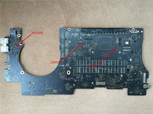

Okay so the temperature sensors are pretty much on the other side of your board. Since you did not move it at all etc. it is unlikely that those are at fault but you asked for it :-)
GPU PROXIMITY/GPU DIE/LEFT FIN STACK/RIGHT FIN STACK Reference designator U5850
DDR3 PROXIMITY/CPU PROXIMITY/PCH PROXIMITY/AIRFLOW PROXIMITY Reference designator U5870
X87 PROXIMITY Reference designator U5823
TBT DIE Reference designator XW5820
oldturkey03. Did the photo I posted help at all? I replaced the paste because when I bought it the original owner said it had never been done. The laptop is 7 years old and in my experience paste that old is going to be less effective. And indeed the old paste was crumbly and dry.
Keir Briscoe sorry I missed that new post altogether. Yes, the image clarified that it was my old eyes. the fuse for the trackpad looks okay as well :-)
