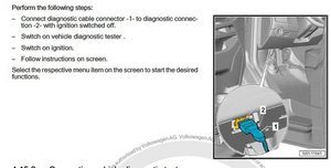

Hi @hellomacos
Get the vehicle's ODB2 port scanned for any error codes.
If there are any codes they will tell you what the problem is. It is the quickest way to know what the problem is.
Places such as AutoZone etc in the USA do this for free
Here's an image to show where it's located
(click on image to enlarge)
There's lots of info online about what VW T6 ODB2 codes mean once you know what the codes are.
