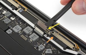

The webcam is no longer recognizable on my mac. Also, the keyboard lights come on when I first start up or open my MacBook but then shut off. No matter how often I push the buttons to brighten or dim the icon image no longer shows on my screen. I went to "System Preferences" > "Keyboard" and there was no option for the keyboard lights.
One forum mentioned that the Keyboard light and the Webcam are connected at the same spot on the logic board. But I don't know where.
Any ideas on how to fix this?

The cable for the webcam module does unplug from the T-CON board, even if you can't get at the other end since its under the display panel. You can also attempt to reseat the eDP cable. In the image, orange is webcam connector, yellow is the eDP connector. You'll just have to remove the silver cowling with a T3 screwdriver to get at the webcam connector and a couple of cowlings for the eDP cable.

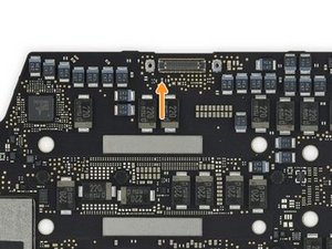

Generally though, this is due to an issue with either the T-CON board, the webcam module, the logic board, or some combination of these. Most commonly replacing the display is going to end up being necessary. If you're extra adventurous, you can take the whole board out and check to make sure the inductor for the power line is intact, it's on the backside of the logic board, just under the eDP connector on the board side. Have seen more than one issue where this inductor blows. In which case it will look damaged, or will be missing altogether. It generally will not blow without an underlying issue, so if this is part of the problem, a new display is likely still necessary, in addition to replacing the inductor.
