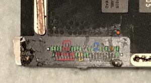

I was trying to replace the power connector on my iPad 7 and I pulled some pads will need to use some jumper wires. Does anyone have a pin out diagram for this connector?

add a photo of the missing pads, might be no connect or ground
It's a little hard to make out from your pictures which pads specifically are pulled. But I think really there's only one I can absolutely identify that you need to worry about.
I forgot to actually write what's what in the pic. But really it doesn't matter all that much aside from noting that anything connected together/the same color is redundant and likely doesn't need to be replaced. The orange one is the only one I would be concerned about since it definitely looks pulled and no other pin on that line. You should be able to just scratch up some of the trace there that's coming off the pad for a jumper. If not, there's a test point on that line as well which I colored orange to run a jumper to.

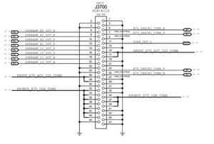

Also put the schematic here for this connector just for reference. I can revise for any other pads you're having issues with if i missed something.

Can you send full charging port Diagramm
Mine are pulled out
Mine are pulled out and what's with the uncolored ones
@rayanamee You might be better off posting a new question with an image of what you're looking at. But all the uncolored ones are ground. And plenty of grounds, so its not necessary to reconstruct all of them if you pulled a few ground pads.
