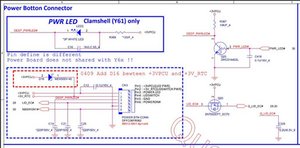

Does anybody know which of the 6 pins in the power board cable can be shorted together to start the computer?  If that works, I will know that the power button board is bad, and the system board is good.
Where can I find a schematic for my system board?

Did you disconnect the battery from the motherboard after you opened the laptop and before you removed/replaced the power button board?
My motherboard is stamped "DAY62PMB8E0".
I would love to figure out which two pins of the ribbon cable can be shorted together to power up the laptop. For that I am going to need an accurate schematic.

Hi @wiley1 ,
Here’s a link to the schematics (I hope relevant to your motherboard)
Here’s an image of the connector CN3 which shows the pinout of the power button board that may help (pins 2 & 6 for the power button). Check for voltage on +3V_RTC if temporarily shorting these two pins out doesn’t work.
