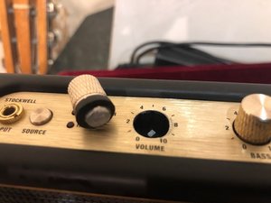

My portable Bluetooth speaker Marshall Stockwell fell from a height and broke the volume control and knob.
Can anyone tell me the volume control part number and how or where can I find it?

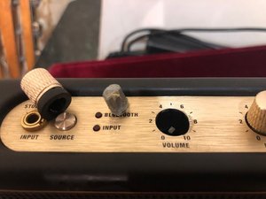

Yes, it works well just the knob to the controller connection shaft is broken.
Your provided list of potentiometers is very similar to the needed one, just instead of 6 connectors on micro-pot and on marshall, it has 3.
I decided to go with your advice and try to fix the knob with proper epoxy, only thing I'm worried about is that the knob of this potentiometer is retractable and going up and down giving the volume button to hide so less epoxy can not hold in properly and more epoxy can make an obstacle for retracting.

Hi Emilio,
I did already and only what I found was R103
written on the controller at the very bottom, nothing else is visible.
I tried to find it by google but nothing :(
Here is what is broken:

Hello
Have Update:
I teardown speaker, tried to remove the PCB where a potentiometer soldered but couldn't. it's really hard to do without damaging the speaker case, so I left doing it and simply glued it for temporary use because there was very limited access to fix it properly without complete stripping down.
Same time I purchased a broken speaker as a spare part and plan to replace and collect one good from two.
Hey @datooooooo, nice that you figured out a reasonable solution for your problem. Companies often work directly with the manufacturers and they are able to keep those parts out of market. Unfortunately, as you experienced, they don't provide support for a proper fixing.
However, given the nature of the broken part, I think you did right. Couple of drops of glue/epoxy was the easiest option, and maybe the temporary use becomes years!
