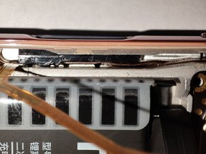

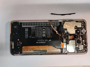

Hello, somebody know how to replace Xiaomi POCO X3 fingerprint sensor ? I am not a begginer i can do microsoldering as well but this one is bit tricky i think. Sensor is located in such a narrow area and a im simply scared i am going to rip it off. Do i need to preheat and push from the outside? Did somebody make this replacement? Any ideas please?
My finger print is not working and lost icon fingerprint from security menu

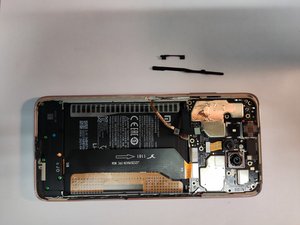

Hi. First you have to take out the plastic bracket which holds the fingerprint sensor in place. Then you can slide the sensor outwards.
Btw. the power button ist underneath the fp-sensor and gets pushed when sensor is pressed.
Yeah, thats what i needed ... photos :) Going to open it. Thanks!
