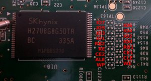

The final option is the most difficult, make a hardware dump of the current state of your eMMC user data, and Wii U NAND.
And try to manually repair the dumps on a PC.
Here are some images from WiiUBrew, good luck!
eMMC:
NAND:
