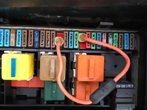

I have a little mystery to figure out. I have my battery drained by a component connecting via fuse 31, namely: clock anti theft, immobilizer, instrument cluster power, buzzer, board computer, they are all on there. The draw is 0.25 amp for 60 seconds, then drops to 0.05 amp , which would be nice if it would remain there, but alas, it comes back to 0.5 amps after 60 seconds precisely. One local tech told me about the BMW board computer having a dedicated small watch battery which died and caused a similar effect in another BMW. It sound very plausible to me, given the regular nature of the intervals, one could nearly rule out a stuck relay or short.....or am I mistaken? So did anyone ever dig out the computer and find such a little battery which can be replaced? Or did anyone ever have a similar pattern and found the solution? Another weird thing is, that when I pulled the fuse, the car started up as if nothing was missing, except for the cluster no longer indicating its stuff. What gives here?
After reading just about anything I could find on the draining issue, I think I found a very slick solution: I will just reroute the power supply for that circuit from the current "always hot" fuse, and instead supply the power from one of the accessory fuses which only become hot when the key is on. The I only need connect the clock to an always hot wire,and I will lose my trip meter settings which I do not care about, and voila....
How did you make that reroute wire set-up? What size fuse is in it and it looks like you have pulled fuse 31 and the other fuse slot?
HI, I have the same problem and looking for a quick fix and have seen this solution mentioned before. In the picture it looks like you are jumping fuse 16 and 20 - how does this effect fuse 31 circuits?
Hi Philip, the picture above is not of my BMW but another person's vehicle. I used the switched accessory fuse, and did a similar bridge to the fuse 31 in my BMW. I will provide my actual setup pic shortly

Hi folks, here is a more accurate picture of the actual BMW Z3 fuse box (instead of the generic one for other BMW models I used earlier to illustrate the idea of fuse bridging) and the jumper cable I installed. I used fuse 44 which is switched on only when the key is on, it is for the foglights and inserted a jumper to power fuse 31 (computer and dash functions) to make its components also switched by the key. This now enables the fuse 31 functions only when your ignition is on, and eliminates the power drain which occurs through fuse 31 all the time, draining the battery.
Good tip, thank you. My dad’s Z3 is always dying from a discharged battery, I will try that.
