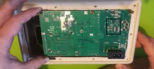

Hello! I have a problem similar to a couple of other topics where fuse blows immediately. However, my speaker works fine from battery if it's recharged externally. Also, there is nothing is obviously burned or damaged on the board. Any suggestions how to diagnose the problem? Thank you!

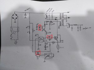

Thank you, @jayeff ! I’ve found schematic of Marshall Stanmore on this link and attach the images
https://www.elektroda.com/rtvforum/topic...
would you be able to suggest which element of the scheme may cause short cicuit please? I’m no expert in electronics but would assume that if something is burned/broken it should stop the flow of electric current rather than accelerate it?

Hi @timlar ,
if it only blows the fuse on the AC input and works OK on the DC supply you may have to start checking the AC from where it connects to the board and gets to a power transformer and then a diode bridge so that it is rectified to produce DC to operate the device.
This is difficult without a schematic however you could try contacting the person in this link as it seems that he has schematics of the power supply.

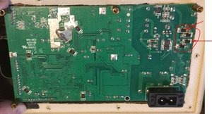

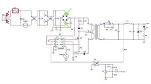

Hi @timlar ,
Firstly, have you replaced the blown fuse with a T1.6A 250V fuse and not a 1.6A 250V fuse? The fuse rating should be stamped on the fuse end connectors. The value is also shown on the image of the board that you posted.
The T rating is very important because this denotes that it is a slow blow fuse (T= timed) and not a standard fast acting fuse (aka, a normal fuse). They are designed not to blow when the AC power is first connected due to the high inrush current which flows in the circuit. This current lasts for only 10mS (milli seconds) before it subsides. A normal fuse will blow every time due to this inrush current flow but not a slow blow fuse, that is why it is used. The inrush current flow value can be as much as 20 times the normal current flow that it used by the device.
I think that the schematic you posted is only similar and not the one for the device as for a start the fuse value is different. The schematic shows a T2.5A and your board is a T1.6A
However, for a fuse to blow every time, you need to have a very low resistance path or a short circuit i.e. 0.00Ω between the two AC input leads i.e. the active and the neutral on pins 1 & 3 as shown in the image.
With the power disconnected from the device and the correct fuse inserted, place an Ohmmeter across pins 1 & 3 of the AC input connector on the board and check what the resistance measurement is.
If it measures a short circuit as you can see there are a lot of components connected directly between the two wires from the two red arrows to the 2 green arrows and none of them should be short circuit.
You will need to disconnect (unsolder) one side of each component that connects between the two wires, one at a time, until the short circuit disappears when testing between pins 1 & 3. Once it does then most likely you have found the faulty component.
Testing at board level with no obvious visual damage takes time and if the schematic is not the one you will have to trace the tracks on the board to find out which components are connected in the path

Thank you so much, @jayeff ! great point regarding the fuse. Indeed, I was using the fast blow fuse instead of the slow blow. Unfortunately, having switched to the slow T1.6A this time round, the only difference is that the slow fuse blows less spectacular compared to the fast veresion - only a flash , without a bang :)
So, I recon, it would have to be a hard way but a motivation to learn some of the electronics basics. Was on my wish list for a while but never had a real life challenge to apply it to. Now I do! One option I toyed with is just charging the battery from an external source but having inverted in the tools and spares I might as well try to fix it properly - and fingers crossed I won't burn the whole thing permanently.
@jayeff - when you suggested to take out one element at a time, why can't I just measure their resistance without unsoldering from the board, searching for the one with 0 Ohm?
@timlar
You could try but there are a lot of components in parallel connection across the two wires and this lowers the overall resistance value (Ohm's Law for parallel circuits) and the reading may be misleading, especially if the faulty component is low resistance and not short circuit.
By removing one leg of a component from the circuit you are only measuring that component and not any of the others that are also across the wires at the same time.
Also if the short disappears when you have removed one leg of a component and you're still measuring at the input, you're fairly certain that it is the problem without even having to individually test it further ;-)

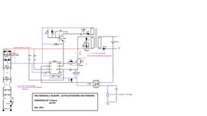

I have drawn up the schematic of a Kilburn, the other models, acton, stanmore etc. are primarily equal to each other I think. Secondary there are differences, there is also a different transformer in it, with more secondary windings. The errors are usually in the primary part. I will try to upload the schematic. Greetings, Jan Hoeve, pe1rfe.
Thank you Jan, this is excellent. I have just picked up a Kilburn 1 with a power fault, and found the following before I found your diagram:

so ... after a couple of years, with the help from this forum (especially @jayeff @pe1rfe - thank you!), ChatGPT, Crash Course Electronics and PCB Design a local reair cafe (https://cambridgecarbonfootprint.org/rep...) I have finally managed to fix my Killburn!
In my case, the fuse was blowing due to two fried diodes in the bridge - they had very low resistance in either direction, while the other two were ~400Ohm in one direction, and very high in the opposite. I ordered replacement S2M and a kind sole at the local reair cafe swapped them in 10 min or so. The speaker is working again! Exiting but long journey - still, was very satisfying (much more so compared to buying a new one) !

LL 10= 2 , 3 micro henry , see my drawing.

The cause that this breaks is a closure in 1 of the components.
The schematic I sent earlier applies to the Kilburn, but the other models are
primary almost the same, secondary they are different and a different transformer is also used.
