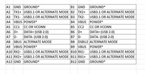

So, my controller's USB-C connection port decided to break off, and I am trying to replace it myself, but my issue is I can not verify 100% what each pin on the breakout goes to on a USB-C male port. So far I have:
TP1 - B4/B9 (VBUS)
TP18 - ?
TP11 - B7
TP5 - B6
TP3 - B5
TP13 - B4/B9 (VBUS)
TP16 - B12 (GROUND)
TP(X) is the labeling on the breakout board itself. Any help would be appreciated

they refer to it as the "phone connector" on the service guide. My issue is basically the USB C header came off, and for me to make a new one, I need to know where the pins on the USB C port correspond to the 7 pins on the breakout.
souswodaem1 use your ohm meter and go from the USB C connector to the TP connector and see where each one terminates. Then use the standard USB C wiring to determine which connection that is and where it connects to the TP.

I took the pins from the good side, added some opacity, and made them line up with what we see on the other side. Doing this, plus a little more testing with the ohm reader, we can see that TP18 DOES in fact have a connection, and it seemingly is connected to the A5 USB-C pin.
Is there a reason I would have a pin for A5 and a pin for B5? wouldn’t A5 and B5 be interchangeable? I ask because my USB-C Male PCB board only gives me access to one set of pads, so, if I were to wire up TP18 and TP3 to this PCB, they would be fighting over one pad.
I guess if they need to be separated I can try to get a jumper from the leftover pin (let's say it is TP3) and jump it to the other CC/VCONN. My assumption is, A5 and B5 work together, and if A5 is CC, then B5 is VCONN. Then if you flip the C connector, that same pin I called A5 is now VCONN, and the same pin I called B5 is now CC.
I think that is why I kept getting confused, because I was assuming the USB-C male pads had different names, when in reality, the pad in the top left is A12, and the pad in the bottom left is B1, no matter which side of the connector is facing up. Huh, that is super cool.

I did a continuity yesterday with a cut wire plugged into it to see which of the 4 wire connected to which of the 7 pins and the results were
Tp1 - red
Tp18- unused
Tp11 - white
Tp5 -green
Tp3 - unused
Tp13 - red
Tp16 - black
Not sure of the two unused pins are something my standard usba 3.0 cable didn't support but the controller functioned through the connection before I cut the wire.
