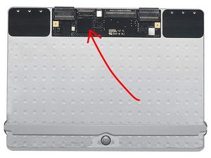

My macbook recently died, i opened it up and tried disconnected stuff until the fan started spinning. After disconnect the keyboard ribbon, and plug in the power, it booted. Connected everything else and still boots. I plug it in and it’s dead.
Should i just replace the keyboard all togheter or is there something else to try?

Did you try the power pads?
No, I did now and realised something i didnt see before, although it was there, when using the power button or power pads, it performs an smc reset.
@måns Hillgren - Let’s get a better view of things, install this gem of an app! CoconutBattery take a snapshot of the apps main window and post it here for us to see Adding images to an existing question
@danj ive only been debugging this without the battery.
A chip on the trackpad board is getting really hot when plugged in after booting.
https://guide-images.cdn.ifixit.com/igi/...
Thats a bit of useful info! Time to replace the trackpad MacBook Air 13" (Mid 2013-2017) Trackpad and MacBook Air 13" (Mid 2013-2017) Trackpad Cable. Here’s the needed guide MacBook Air 13" Early 2017 Trackpad Replacement

Thank you, will do.
