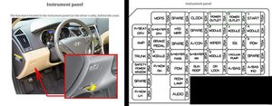

Where is the ciggarette lighter fuse
Where is fuse for ciggarette lighter?
Hi,
There are two front power outlets, each with their own 15A fuse.
Here’s an image that shows the location of the fuses.
(click on image to enlarge)
